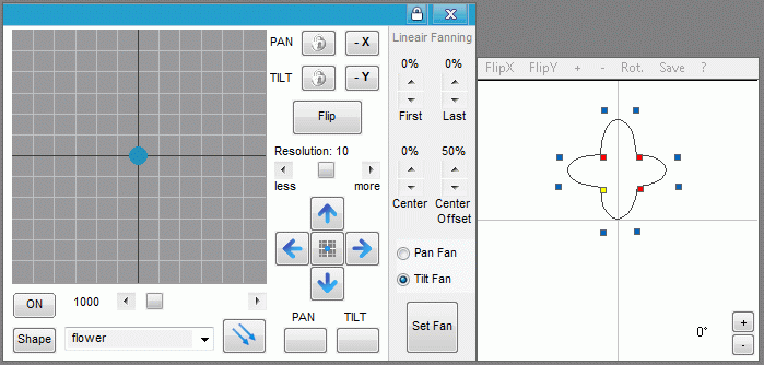

Select the wanted fixture and open the “Sequence panel”.
Open the “Movement panel”, select the shape.
Here ”Flower”.
Press “ON” and then “Shape” to open the view the shape.
Scale the figure and move it to the wanted position.
As the figure has been turned on the changes can be seen immediately.
Save the sequence.
Pan and Tilt don’t have to be set to fade as this is implicit in this function.
Repeat this for all the wanted shapes.
