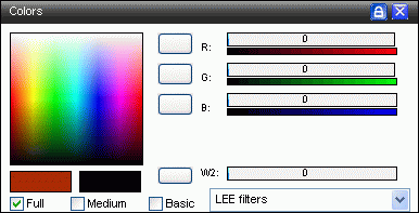

In FreeStyler the will be a lamp and color control panel.
Link to Panel Description - Lamp Panel
