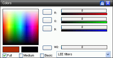

Fixture Creator - Lamp Configuration
In FreeStyler the will be a lamp and color control panel.
