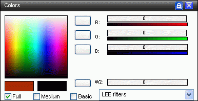

Enter manufacture name “Chauvet”, Fixture name “ColoradoZoomW 4ch” and Select the fixture picture.
Enter then Total Channel. Here in this mode it is 4.
Check “on” RGB.
Additional the fixture has a white channel.
Fixture Creator has two white channel contols W1 and W2. Here W1 is chosen. There is no difference if the one or the other are used.
In FreeStyler the will be a color control panel.
