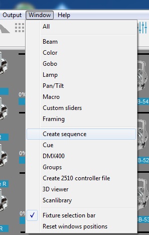

Open the sequence editor
Launch the sequence editor (Window → Create Sequence)
or use the shortcut in the toolbar
The sequence editor will open

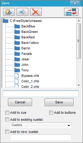

Save a sequence
Once you have taken several snapshots, it's time to save your current sequence so that you will able to play it during your shows. Click on the quick save save button if you have already saved it with a name, or you can use the save as save as button to give it a new name.
Enter a file name.
You can additional chose to tick on some of the “Add to” options but this can also be done manually later.
Add to cue: Add this sequence to the cue in the cue window. See Playback Sequence
Add to buttons: Add this sequence to an override button in the override window. See Override buttons
Add to existing cuelist: Add this sequence to the cue list in the selection box
Add to new cuelist: Creates a new cue list with the name entered in the box bellow and add the sequence to it.
NOTE: you can manage your sequences by creating folders (e.g. one folder for each group, or separate folders for colours/intensities/movements).
NOTE: These sequence files can easily be copied from one PC to another (if you have the same fixture setup).

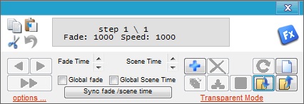

Edit a sequence
When editing a sequence, you can move from one step to another with the browse steps browse buttons.
You can choose to:
  • insert insert a step after the current one.
  • delete delete the current step.
  • set set the current values to all steps in the sequence.
It's also possible to use shortcuts to copy, cut, paste or undo the current step. edit
With the sequence editor, you are able to:
  • adapt the scene time (total length of the step including fade time)
  • adapt the fade time (time during which DMX values will change from the previous value to the current ones)
  • set the same scene time to all steps
  • set the same fade time to all steps
See. Scene and fading time

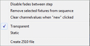

Options
“Options…” is found in the lower left corner of the Sequence editor.
Disable fades between step
This function removes fade time between scenes during editing playback.
This is useful when long times between scenes are used and a fast scroll between the scenes in edit mode is needed.
When this is “on” the scenes appear immediately when the “Left” or Right” arrows are pressed without waiting for the steps to fade.
Remove selected fixtures from sequence
During programming, it may turn out that a fixture you've set values for doesn’t fit into your scene. With this option, it is possible to remove the unwanted fixture without having to re-make the sequence again.
Clear channel values when “new” clicked
This function clears all values by setting them to 0.
NOTE. Clear is not the same as default values.
Transparent or
Static
The sequence editor can be set to record the scenes in two modes, Transparent or Static.
In transparent mode, the sequence editor only records the channels that are changed or set to “Fade” / “Snap” in fader panels (not those set to “Off”). This makes it possible for other sequences to change the other channels not included when this sequence is running.
In static mode, all channels are recorded by the Sequence editor. This makes it possible to set the whole light to a wanted state and then record all channels.
As an example on these two modes imagine a setup where a lot of sequences are controlling various fixtures via sub masters. Some sequences control movement, some colors and other gobos.
In certain situations, the lights are to be in a well-defined setup. This could be lights on the audience and the scene in an introduction. This is set once and recorded as one static scene.
Attach the sequence to an override button and it is now possible to have all the light in various settings and then by pressing this one override button, all of the programmed lights will be set for the introduction scene.
Status of the Transparent/Static mode seen in the lower right corner of the Sequence editor.

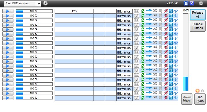

When you running a show you will run one or more sequences simultaneously. All sequences can be replayed in the cue which takes up to 20 sequences at the time. The sequences are to be added to this cue list, which are shown in the CUE window in order to be replayed.
An additional way to use a sequence is to use an override buttons . The override button will not replay a sequence but only set one scene as it is an override. If the sequence are to be used as override then make a sequence dedicated to the override containing only one scene.
Note if there are more scenes in the sequence then only the first scene will be set by the Override button.
As mentioned above under “Save a Sequence” you can tick on if freestyler automatically are to add the sequence to a cue list or an override button. But this can also be done manually later.
