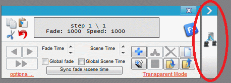

Presets are found in the right side of Sequence editor.

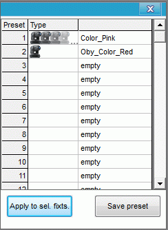

Select a preset field and press “Save Preset”
An icon in the Type field tells if it is a Fixture or global preset is saved.
Give the preset a proper name.

If a Fixture preset are to be used then select the wanted fixture of the same family and select the wanted Fixture preset.
Press “Apply to sel. Fixts.”
The preset is applied to all of the selected fixtures. Note that more presets can be added to each step in the sequence.
