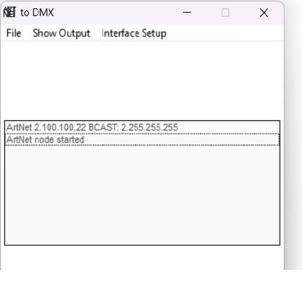

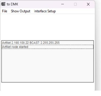

Hello,
I love the little program Art-net to dmx. It is a life saviour!
However, it has stopped working for me. Since today when I want to start the program it immediately crashes! For a few seconds the window opens as here:
Then it closes and that's it. It is not running in the background. It has worked the day before! :( The only thing I did was restarted my laptop in between sessions. There were no Windows updates in the meantime, I checked.
What I already did to solve it:
Unplugged all USB cables
I restarted my laptop (win11)
I checked for Windows updates.
I reinstalled the freestyle software (first I removed the old software).
Disabled firewall.
I did CMD > sfc /scannow
Tried to install older versions 3.5.6 and 3.5.7
> Do you know any other thing I can try?
> Do you know any similar software I could use? I run an Enttec DMX USB PRO (So USB in, dmx out)
> Do I need / How can I fully completely remove the software for a reinstall?

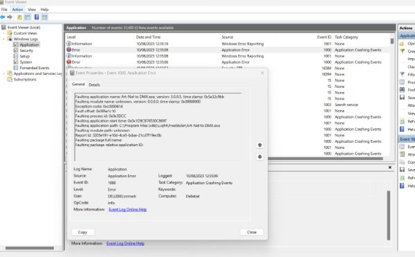

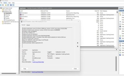

Hi All,
An update on the things in tired - no success so far.
I found the crossing in Windows logbook as a generic "Application error 1000". (see image below).
What I tried to fix it:
https://www.minitool.com/news/event-id-1000.html
Ran additional anti-virus (again)
Clean Boot (no thirty-party programs)
Run in Compatibility Mode
System file check through sfc /scannow (again)
CMD > DISM /Online /Cleanup-Image /RestoreHealth
> Can anyone confirm the program uses .NET Framework?
