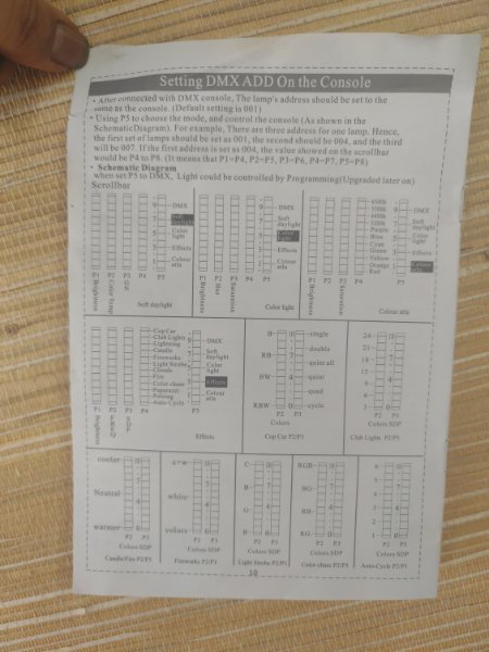

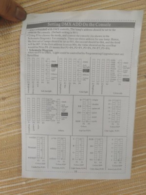

Hello all,
I'm new to Freetyler and this forum.

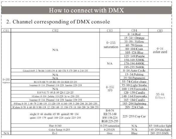

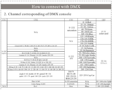

I have this led rbgw panel from Alibaba and I can't figure out how to make that file to allow more control of colors.
I have the dmx chart attached but can anyone tell me if this light is actually able to allow individual RGB control?
And if so can anyone help me build that file?
Thanks and be well.

Can you either provide a link to the user manual or else include it as a file attachment to this thread?
From the chart you did include it looks like the instrument can be controlled via DMX but it is not clear.

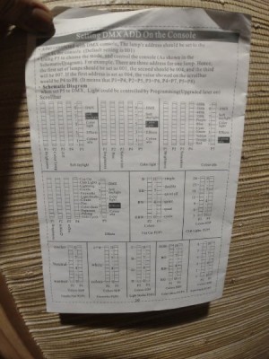

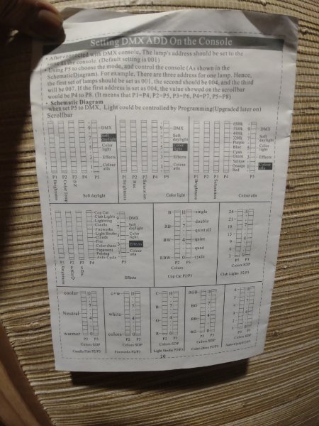

Whoops hire resolution

It is difficult to read the page but, if I understand it correctly, there is a setting that will cause the instrument to react to programming from a DMX console or lighting software (such as Freestyler).

Here is for the ai3000c, as I have that light also and the instructions were the same I believe
