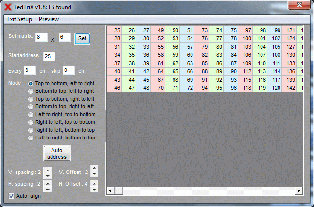

To use the matrix together with LedTrix some setups are to be performed.
The setup are found under “Plugin” → “LedTrix” → “Setup”.
The Matrix is 8 high and 6 wide. 8 x 6.
Remember to press “Set”
Each fixture is 3 channel so: Every 3 and Skip 0.
Top to bottom, Left to Right.
Auto align: on.
And press “Auto address”
For more detailed Setup info See LedTrix – Setup Window
“Exit Setup”

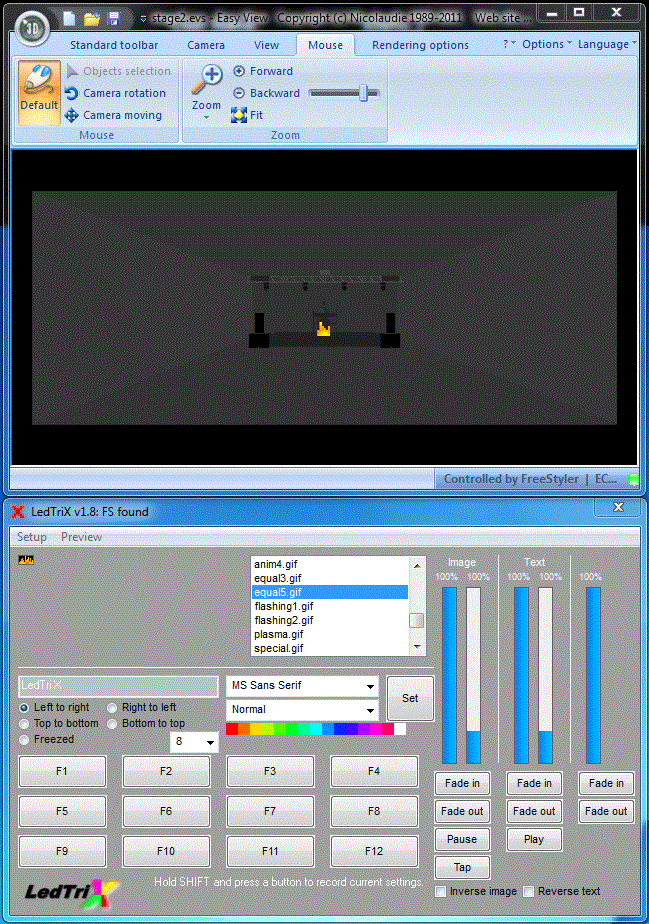

One thing to say.
Play with the LedTrix.
See eventually: LedTrix - Main window
Click on some of the animation gif’s.
Get a feeling with the functionality.
