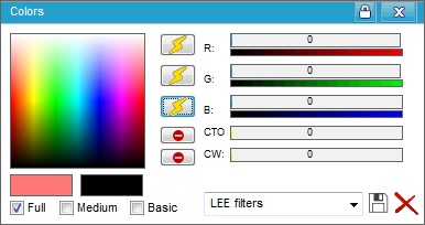

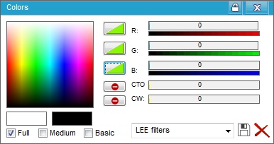

If you open the sequence editor and start changing the colors of a fixture then the color faders will by default change to fade mode.
This will give that the faders gradually moves to the next value.
The effect will be that that the color shift can look a bit like rainbow.
Alternative if pressing the button in front of the fader then the shift will be instant and the color shift will direct.
If a color shift is to be fading with the same color then you need to set in an extra step in the sequence.
The color faders are to be in fade mode and then the extra step in between the two colors are to be no light.
Example: Red to Green fade.
Step 1: Red = 255, Green = 0, Blue = 0
Step 2: Red = 0, Green = 0, Blue = 0
Step 3: Red = 0, Green = 255, Blue = 0
