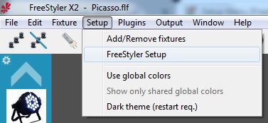

The FreeStyler Setup menu can be found under “Setup”.
Under this menu the following can be found and set.
Add/Remove fixtures

Use global colors
Dark theme
Dark theme changes the background color in the panels from white to a dark gray.
