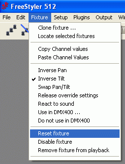

If the reset channel is configured then it is accessed via the dropdown menu “Fixture” → “Reset Fixture”.
The fixture need to be selected.

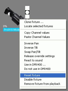

Alternative the menu that appears with Mouse – Right click also have “Reset fixture”.
