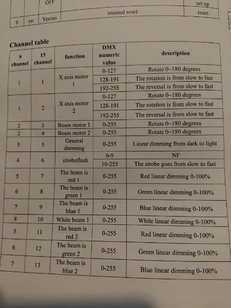

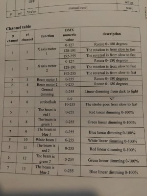

Hello all,
I have a problem i cannot figure out. I have a double moving head with 15 channels. The heads can be controlled seperately because both heads have a different dmx channel for pan and tilt in 15 channel mode.
Double moving head.jpg (5.03 KiB) Viewed 27703 times
I need to be able to use the pan of the heads in mirror. As fixture creator doesn't allow multiple channels for pan and tilt i cannot figure out how to do this in one file. I have added the channel list below.
Hope someone can help me
Regards
Andre.

Re: Double moving head 6 LED
Post by Rod_Horning »
The channel layout is most unfortunate. With other fixtures such as this the solution is to define multiple fixtures. In this case it would be 3 fixtures. 1 fixture for pan/tilt of one head. Another fixture for pan/tilt of the other head and a 3rd fixture for the rest of the functions. This will not work with this fixture due to the pan/tilt channel layout. I think the best you can do is define a 15 channel fixture with one head as pan and tilt, say channels 1 and 2, and just label channels 3 and 4 and use the sliders in the upper right hand corner to position the 2nd head. The other functions can be defined as usual.
Good luck.
