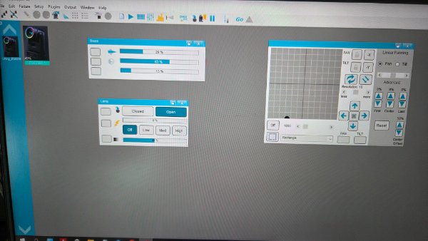

Hi
Thanks!
I can move it
Dim it
Have the gobo rotate
But no colors, LED ring, or gobo changes They are greyed out in the software
Thanks!
I can move it
Dim it

Re: **PLEASE HELP** Uking ZQ02360
The reason those are greyed out is that, while I labelled the channels with their function, I did not define the channels to Freestyler as a color wheel or gobo wheel. The reason is that the documentation did not indicate shapes, colors, etc. You can still select colors, gobos, etc. with the sliders that appear in the upper right hand corner of the Freestyler window when you select the instrument.
I will update the fixture definition but, without information as to the colors or gobo shapes, the only thing I can do is put a GIF with a number. This will activate the functions that currently are greyed out.
