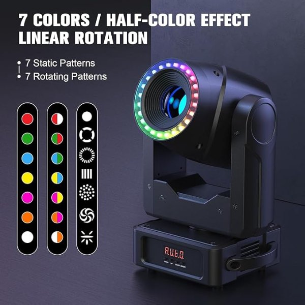

Hi,
I need a profile for these lights:
Uking ZQ02360
THANKS!!!

I will create a fixture for you. I am traveling so it might be a couple of days.
Is this your fixture?

Hi,
Yes that's it.
Thank you so much!!!

The reason those are greyed out is that, while I labelled the channels with their function, I did not define the channels to Freestyler as a color wheel or gobo wheel. The reason is that the documentation did not indicate shapes, colors, etc. You can still select colors, gobos, etc. with the sliders that appear in the upper right hand corner of the Freestyler window when you select the instrument.
I will update the fixture definition but, without information as to the colors or gobo shapes, the only thing I can do is put a GIF with a number. This will activate the functions that currently are greyed out.

Awesome thank you!
If I gave you pictures of the gobo's would it help?
Moderator
Posts: 905
Joined: 16 Nov 2016, 14:24
FreeStyler Version: 4.1.7
Re: **PLEASE HELP** Uking ZQ02360
Post by Rod_Horning »
Yes if you can provide the DMX values. The chart you posted does not give the specific DMX values for each color and each pattern.
