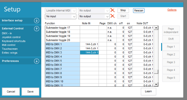

I don't know that this helps but I was able to do the following:

Hi Rod_Horning, thanks for your response. I'm curious how you were able to perform this? In my case, each time i select MIDI to DMX {channel number}, then rotate the knob on my MIDI controller to trigger the MIDI channel assignment, it's only possible for the first selected MIDI to DMX record.
It's simply impossible to repeat this operation for next rows to achieve my goal, as each time I do it for the new row, it removes the assigned channel in Note IN field in previous row.
Maybe it's due to Freestyler version difference (3.6.49 on my end, while you're probably performing it on 4.1.7)?
Unfortunately, there is no option to manually edit this field and e.g. simply copy and paste values, making it duplicated in consecutive rows.

Yes I am running 4.1.7 so that could be the difference. I just clicked in the MIDI box and typed the info. I did not try copy and paste.
