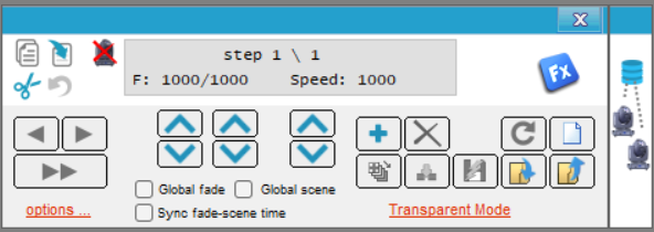

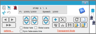

When I click the blue play button in Cue List, each plays for exactly one second which is what I had feared given the "F: 1000/1000 settings that default in the Sequence creator/editor.

Also on the above page there are no durations set but all my cues have "1s" next to them; presumably this was set when I saved the scene.
I feel I am closer but the scenes are still saving with a duration and the key shortcuts are not moving the cues.

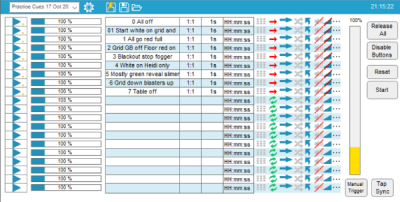

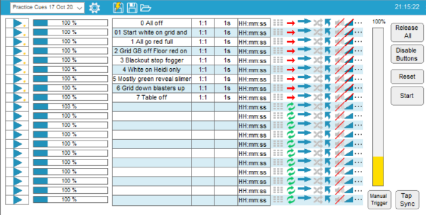

Change the red arrows in the cue window to the two yellow circle arrows. By selecting the red arrow you are telling it to play once and stop. Doing it with yellow arrows will make the sequence continue until the next sequence is selected. the preview button is on left side of sequence window right above "options". The double >> is to play the sequence and single > are to change steps (if added) forward and backwards.

I have set the red arrow to the green loop and the lights stay on when I play each cue now. I understand this is now putting them on an infinite repeating 1 second loop in the cue list so one of my problems is solved.
I have searched all through the Wiki to find how I can use a keystroke to interrupt the looping cue and move it to the next cue on the list but I have not found anything
