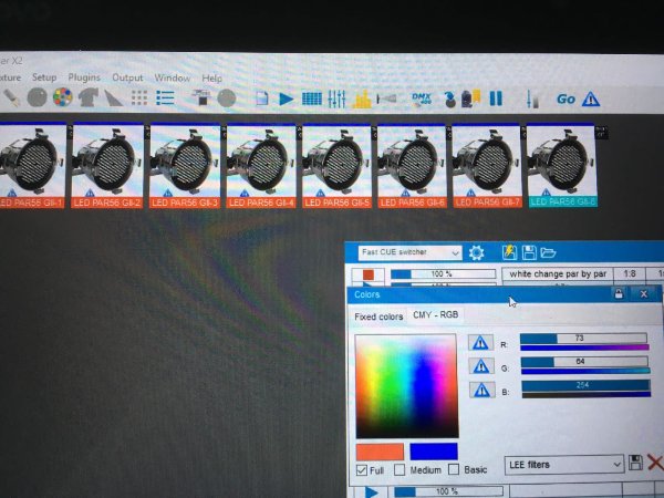

Hello)) i have a question. I made a pattern in freestyler its white color, par by par from left to right. But if i want to change the color for example to red than i cant do it i have a triangle and i have to push that triangle....... is there a way to dissable this triangle?Its a small triangle Thank you)

Is this small triangle the one that is on the left side of the queue window?
Are the PARs RGB LEDs?
Are you tying to do this change with sequences?
Please explain in detail what you want to do and how you are trying to accomplish your goal.

I use led pars. Yes i made a sequence with one colour and i want to change just the colour not the pattern.

https://www.freestylersupport.com/wiki/ ... e_triangle
Do your PARs have a dimmer channel or just the 3 RGB channels?
If they have a dimmer channel then you could set up a sequence using the dimmer channel only that generates your pattern. Then set up separate sequences that control the RGB channels (making sure the dimmer channel is NOT in the sequence)

So i made a pattern with the dimmer of than i save the pattern and just put an colour on it

Re: Little triangle in freestyler
One sequence runs the pattern
The other sequences control the color
Run the sequence that sets the color
Run the sequence that runs the pattern
Run a different sequence that sets a different color
