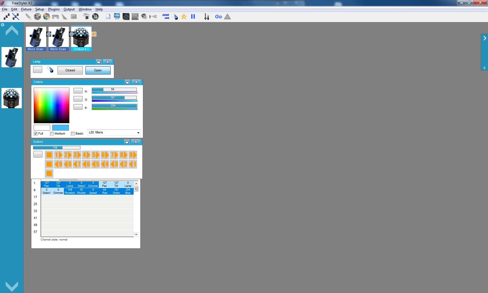

I have two JB Systems Micro Scan II and one Varytec Hellball I in use. I programmed my own fixtures for Freestyler with the fixture creator. Both are working well when I connect the devices via the USB2DMX-Interface (http://www.usb2dmx.com/) so I think it's not a problem caused by the programmed fixtures. The problem occurs, when I connect the scanners (DMX starting-adress 10 for example) via the DMX-Output of the Hellball (DMX starting-adress 30 for example). When I want to control the Hellball, the mirrors of the Scanners are also moving (or the gobo is changing,...) when I modify the values of the different channels of the Hellball.

Can you make a screen dump of the output window where I can see the micro scan channel that changes when you control the hellball
MisterMojo
Re: Devices with different adresses are doing the same?
Post by MisterMojo »
Here's the video: http://www.youtube.com/watch?v=lYbl6_Bc ... e=youtu.be
In the video you can also see how the rotation speed (or direction) of the Hellball is changing when moving the mirror of the Micro Scan.
There's also another problem: when pushing the blackout-button the scanner lamps turn off as they should, but the Hellball is still working. What's wrong with this little bastard?! :?: :roll:

I have addressed my fixtures exact the same way.
One on address 10 and one on address 30.
Don't see the effect.
The only way I can generate this effect is by selecting both fixtures and then use the sliders in right side of FreeStyler.
Are you using the sliders in right side of FreeStyler or the fixture control panels to adjust the fixture with.
And are there a difference if it is the sliders or the control panel you use.

I'm so fu**ing stupid!! Nothing more to say :oops: :oops:
I didn't recognize that sometimes both devices were selected… I feel a bit ashamed :? :shock:
Noobs and FreeStyler.. not the most perfect combination -_-

Like wise. Easy to do. You select 1 fixture then select another keeps previous selected as well. :)
dostie1
Post by dostie1 »
Haha I did the same thing!!!! Suggestion for this thread though to help anyone else out. Goto Setup;Freestyler Setup;Preferences;Colors.....you can change the colors/backgrounds/text of each fixture to give you a better idea of what fixture is actually selected and what's not. I found the default colors a bit hard to distinguish myself.
