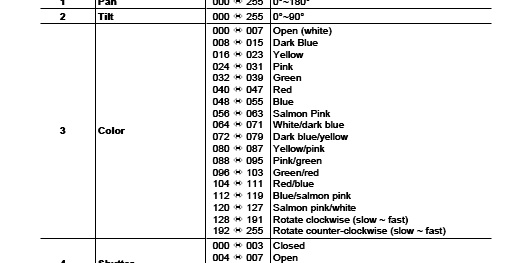

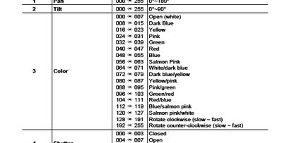

It seems I'm not getting it. When I open the color bar...there is a slider to run through the color changes. Also there are color pictures/blocks so you can pick a color quickly. I updated channel 3 to match the DMX codes in the manual - and updated the color pictures. According to the manual, channel 3 has 20 colors - so I set the color channel to 3 and set the number of colors to 20.
When I am in freestyler, the color squares do not match what I programmed....and clicking the color squares produce different colors on the light (clicking blue makes the light pink)
Can you please look at my channel 3 programming and the chart that I completed - and hopefully you can tell me where I went very wrong.
Many thanks - Ryan

I have been counting colors on channel 3 there are only 18 or am I using a wrong manual.
I have changed the color wheel so it follows the table above.
I uses mid values so the color wheel alvays will be placed in the middle of a range.
