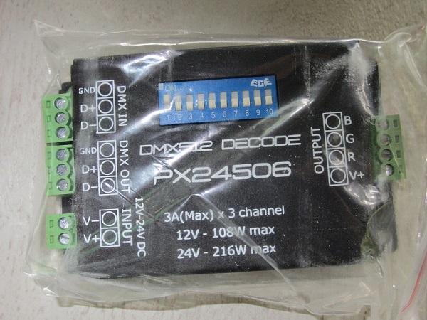

So the pic I uploaded is the analogue driver I bought is it possible to drive single colour uv led strip light off these or do they only do rgb analogue strip?
usLEDsupply
Re: Digital led strip decoder driver
Post by usLEDsupply »
well the strips you got are not digital strips (you can control control the whole strip at once not each section separately)
but they should work with that decoder as it is not for digital strips either
i am attaching a diagram for connecting those
(they are a little different then our strips but the wiring will be the same)
DMX Decoder 6A.pdf

Ok :( so what does it mean by "addressable" in the tittle? I assumed this meant I could control each light. The strips have not arrived yet I may have to send them back and switch them if they wont I guess I will try and find a use for them. Thanks for the help so far.
usLEDsupply
I would say they mislead you (you have to be careful buying from china) you may want to find another use for them as returning them may be even harder then trying to get the right item in the first place.
the ones you are looking for will have a IC Chip on each section and should be called Digital Point Strips or some people call them Digital or Addressable Strips but if they don't have the chip you will only be able to control the whole strip at once
