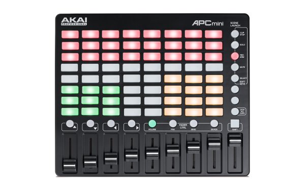

I bought an AKAI APC mini controller to make live shows easier. I had the idea to use the different colors on the launchpad for different situations (i.e. RED -> preset colors; GREEN -> preset movements; YELLOW -> strobe, dimming FX, blinding, etc.).

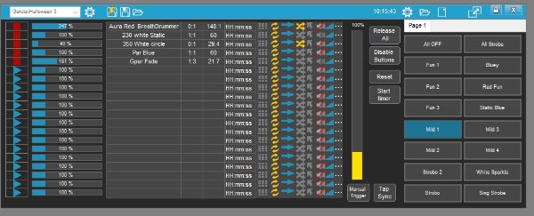

I started making cue lists containing only 1 sequence, but then I am limited to the 16 cue list buttons I can address to the midi controller. When mapping different cue list tabs I thought I would extend the number of buttons I can address. Unfortunately, this is not possible as it is only possible to address one button and not multiple buttons to for example cue list 1.

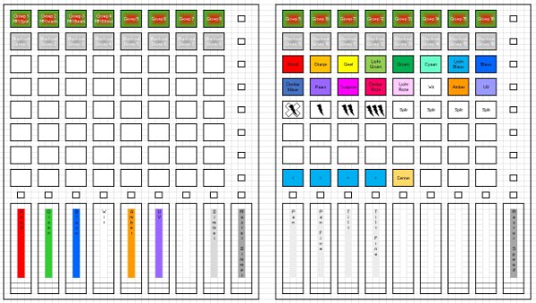

In the attachment I added a picture of the design of the AKAI APC mini I try to achieve. As mentioned earlier RED is color presets (sequences or cues), GREEN is movements and YELLOW other.
