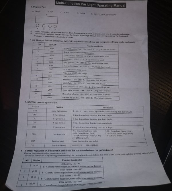

Hi, I just bought this Amazon lights https://a.co/d/6gTe7Cb and it says they work with DMX. I also bought the cable https://a.co/d/gfZZDXv and it seems to be working ok so far.
My trouble is with the Fixture Creation, I've trying to make it work all day and it just randomly works, I don't know if I programmed it wrong or the lights are just not working fine.
I'm attaching the file and my Fixture.
Hope you can help me! :fs:

Photo of the Manual
Photo of the Manual

Explain exactly how they do not work

When I connect them to Freestyler, some features aren't working properly, like colors for example. When you press the blue color, they turn red, if you activate the strobe nothing happens. The only button that works properly is the blackout and the coloring fade.
