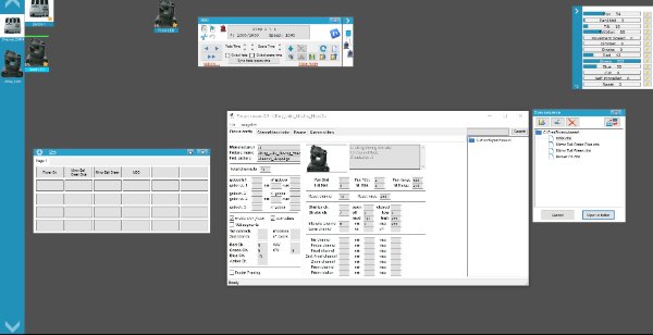

1) Open FreeStyler
2) Open Sequence Editor
3) Select Fixture and adjust channels (Dimmer set to 255)
4) Save Sequence
5) Reload Sequence (Dimmer now set to 0)
0r
5) Open Sequence (Dimmer now set to 0)
Or
5) Exit FreeStyler
6) Start FreeStyler
7) Open Saved Sequence (Dimmer is set to 0)

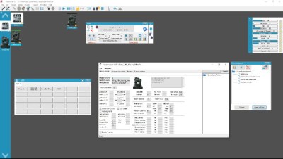

I am attaching JPEG's of my desktop in case that will help.
-JJ
