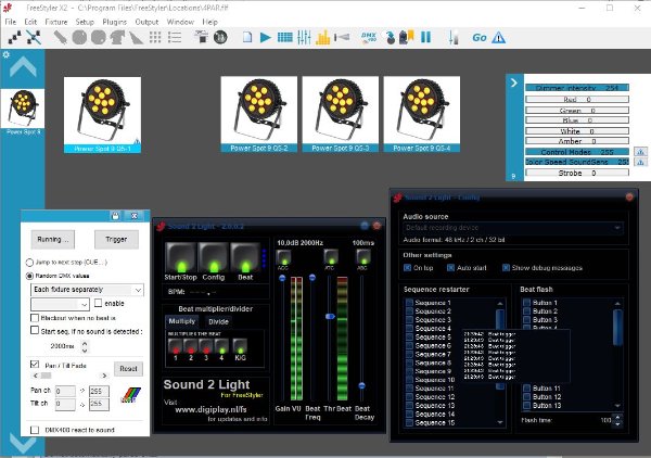

Hello, I'm quite a FreeStyler newbie, therefore... THX in advance for the patience :)
When I start S2L all the leds and meters work properly, but the debugging message says "Beat trigger". Therefore I have no effect on my "Power Spot 9 Q5" pars.
I don't understand where i go wrong !!! Can anyone help me, pls?

The S2L Plugin is running and is sending beat triggers to FS. So thats good.
The one reason I can think of when a fixture is not responding to S2L is that the FreeStyler or fixture config isn't properly set to do something with the beat triggers that S2L is sending to FS.
Please review this (rather old) documentation of how to start using the S2L plugin: https://www.freestylersupport.com/wiki/sound_2_light
So keep in mind that S2L and FreeStyler looks different than noted there, but the basics of usage where kept the same, so with that docs you should be able to get things running.
