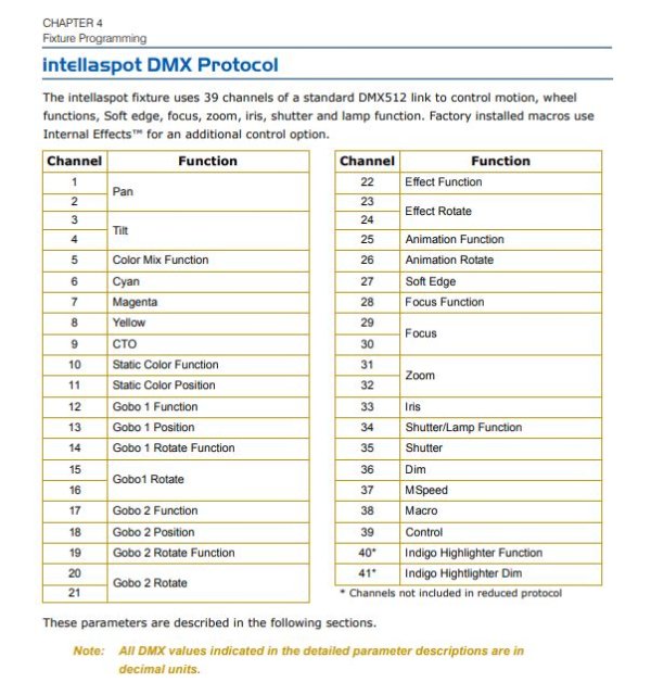

manual is on
https://www.highend.com/documentation/I ... Manual.pdf
DMX protocol is on p.42
screenshot in attach
39channels

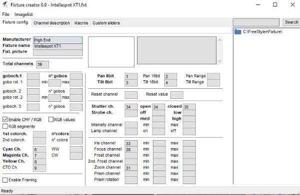

i tried to make a fxt file with fixture creator without gobo, see screenshot in attach, but as i don't know the difference between Focus Function (DMX 28) and Focus (DMX 29 and DMX30), it would be very nice if someone want to review it and/or give me feedback.

Hej.
The information in the manual is not to good.
The DMX values are missing in the DMX table.
Channel 34 is a behavior of the shutter channel. For a start you don't need to set that one.
Shutter ch. and Strobe ch. are both to be 35 if I read the text bellow the DMX table correct.
But the values to enter is missing.
I think that I would try with "Open" = 255, "Closeed" = 0
And "Low" = 10, "high" = 250. These two values you may need to fit.
And you need to set "Intensity channel" to 36. no additional values.
I can not see how you strike the lamp.
And when you test the fixture you need to set the intensity as well as the open the shutter to get any light out.

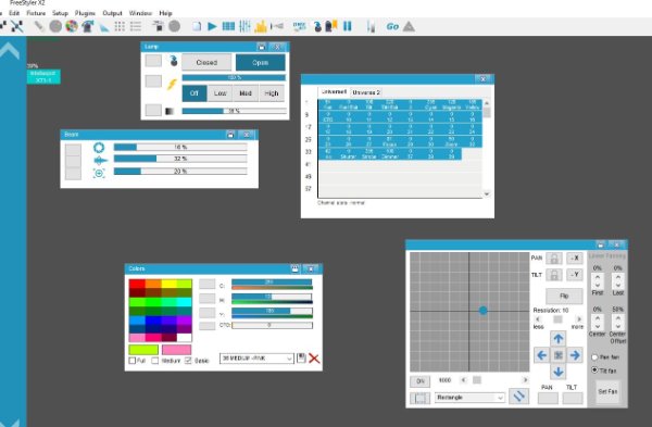

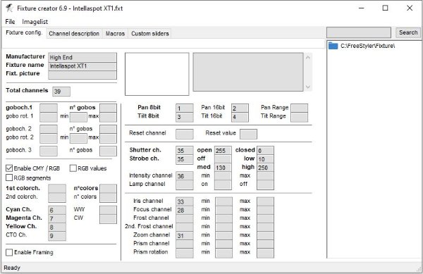

if i understood it right , i made the changes and you can see it in the screenshot:
unfortunately i cannot add the fxt file
although, i do not get any light out of it (controller is ok in settings of Freestyler, and DMX is the right channel 1 on fixture) , i am missing some basic setting and/or i did not understand what you are exactly meaning with
"I can not see how you strike the lamp."

pan/tilt ok
lights on/off not ok, even when testing with all sliders manually on right side
sometimes i see some light appearing for 0,5seconds, but it is uncontrolled
lamp is not broken, that's sure.
exported to pff tnx
sliders on right side in FS is handy , tnx for this too
pan/tilt ok

this 'Intellaspot Luminaire DMX Control Protocol' can help to help me, and others
Intellaspot_protocol_12-9-4.pdf
how to get the light on

If I look at the DMX table
Then 34 = 0, 35 = 255 and 36 = 255 should do the trick.
And 39 = 80 should turn on the lamp.

Re: fixture file for High End Systems Intellaspot XT-1
as you said,
it did the thing,
pff in attach (without gobos)
light can go on and off now, tnx !
it is not yet completely ok, it is mainly purple even when i change the sliders manually Cyan, Magenta and Yellow
it did the thing,
