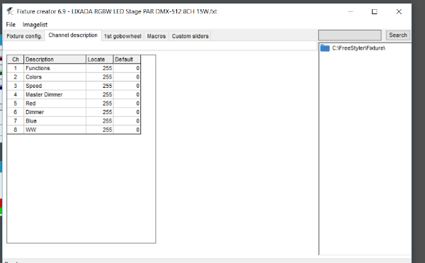

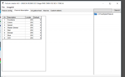

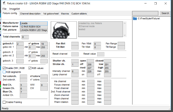

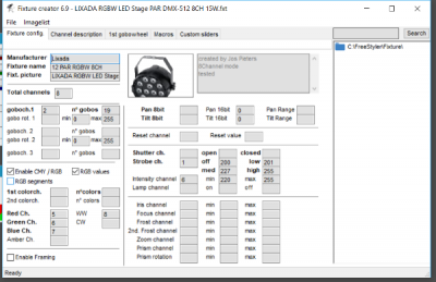

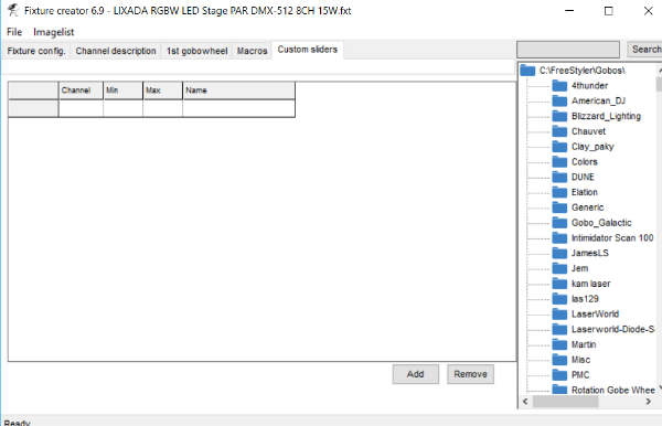

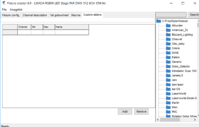

Here is the file I've been using (as it is the same model of the light I have) and editing to try and get the strobe function to work.
Thanks!

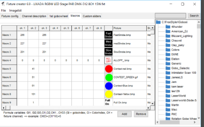

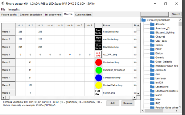

Thank you for assisting. For some reason, I am getting the same results after cleaning the custom sliders and then using the default values listed from the manual. I (think) I set them properly, if not please let me know the error.
I have set the par cans themselves both on CH 16. I keep getting a blue + white wash every time I click any color on the color grid -- the only different is it get's brighter or dimmer. The macros are also not working but I believe this goes along with the first error.
Please let me know if I should edit or review something to get this working properly. Thank you!

Should I remove the preset macros by chance? On the color grid with every color selected I only get a blue output but just the brightness changes.
