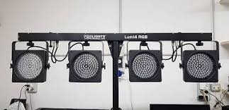

I bought on amazon a LIXADA usb-dmx interface in order to connect it with my 4 parLed kit Prolights lumi4 rgb to use it with Freestyler.
I have not found a fixture for this device, so my question is, may i use another fixture to do this, or i have to create a new one ? I'm not an DMX expert operator so there is sombody able to help me ?

Attached is my attempt at a fixture definition for your instrument.
Please test and provide feedback.
The following programming windows are available for this definition:
Color
Lamp
Macros
Custom Slider (used to select Auto programs).
To control the 4 lamps I used the RGB segments feature. In the Colors window please note the 4 check boxes in the lower left hand corner. If a box (or boxes) is/are checked the corresponding lamp will respond to the color window.
The custom slider to choose the auto program is used since the manual did not specify the specific DMX channel values. If you determine the values either a Gobo window could be defined or additional macros added to select the program.
