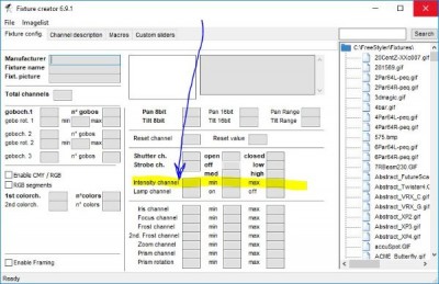

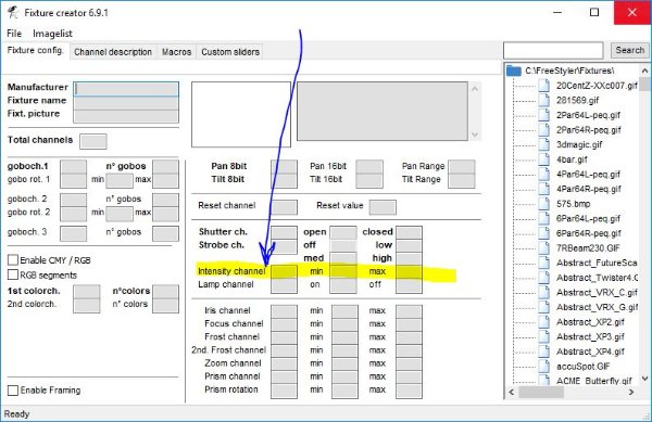

I am having a problem getting the Master Intensity to work with any of my fixtures. These are fixtures I created using the Fixture Creator. I am guessing this is a problem with configuration. Does anyone have ideas on what to check?
- Posts: 883
- Joined: 16 Nov 2016, 14:24
- FreeStyler Version: 4.1.7
Re: Problem with Master Intensity
Check your fixture configuration. Is the Intensity channel coded with the correct channel?
