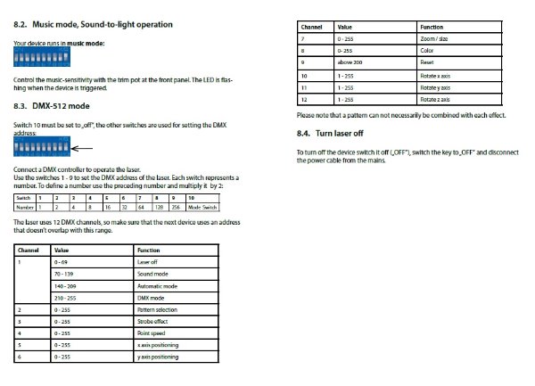

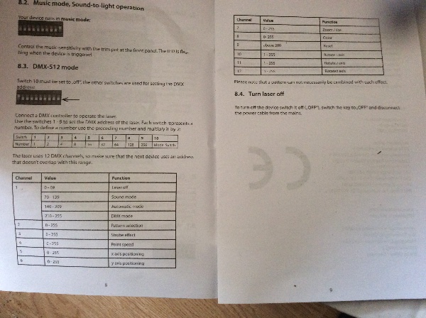

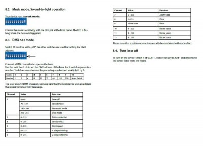

That picture is no good to us. We can't read anything from it, so I'd suggest finding the manual online and posting a link to it instead. Then we should be able to help.

It looks like the forum still reduces resolution on images uploaded.
That may be the reason for the poor image.
Here is a link to the manual.
https://www.laserworld.com/en/support/d ... 16-09.html
