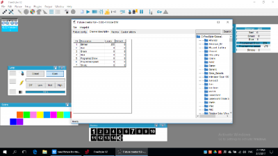

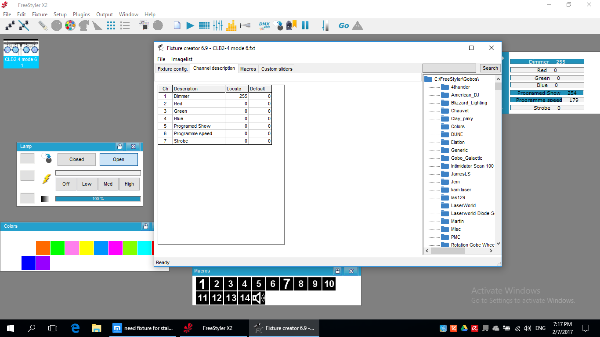

I have made a small change to the fixture. If you would please import it into Freestyler and see if it works.
If it does not work please post a screen shot of all the windows and the output (Output, Show Output) window showing the addresses assigned to the fixture.
Thank you
Thank you

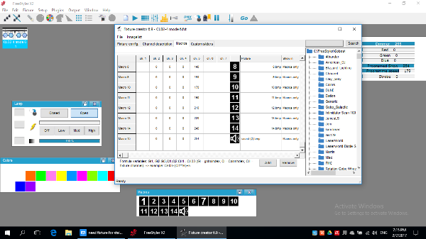

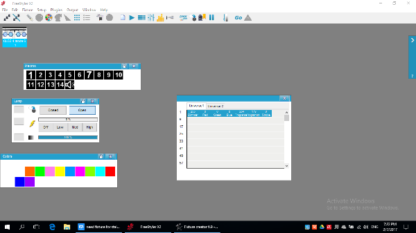

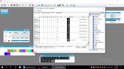

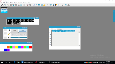

Re: need fixture for stairville clb .2.4
hi again!nothing changed from yestarday test!lo0k the print screen.to give you more informatios.when i press the speaker icon,the lamps stay on to the previus mode without do nothing.
- Posts: 883
- Joined: 16 Nov 2016, 14:24
- FreeStyler Version: 4.1.7
Hi. This is a very frustrating problem. The values shown in the windows you included in your last post are what I expected them to be. Based on my understanding of the user manual, with these setting, your instrument should react to sound. Unfortunately I am out of ideas on how to fix this issue. Hopefully someone will read this series of posts and see something I've missed and be able to help you.

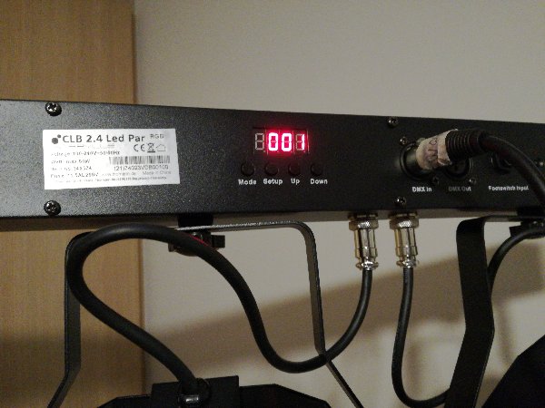

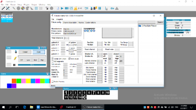

Can you please post the settings in the menu of the device?
- Posts: 883

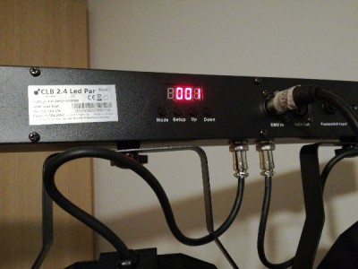

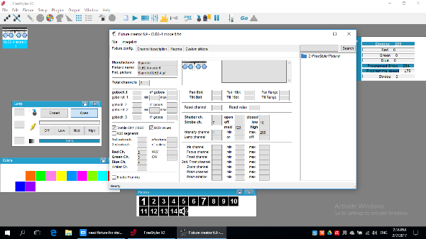

Hi alfa156. I believe that Christian wants to see the settings that display in the little window on the instrument.
alfa156
Did you mean this settings?
- Posts: 883
I believe so. What is the first character in the display? The 001 can clearly be seen but the first character can not. I assume it is d (for DMX) but I am not sure.
If it is d (which is the Mode) then what is the Setup display show?
alfa156
it is d and when i press the "set up' button shown 7 chanell and nothing else
- Posts: 883
Thanks for the reply. That is exactly what I expected. I still have no idea why your instrument will not react to sound. Can you contact the manufacturer's Customer Support and see if reaction to sound really is supported in DMX mode and if the settings in the user manual are correct?
alfa156
Now all works ok and the sound!! Special thanks to rod! Without you i don't know what i do!

something else that i want to ask you.i have to set of stairvilles.i connect the second set via the firts set of instrument and after i go to freestyler and i set a new one icon of stairville clb 2.4 mode 6 ,i adjust d 002 (001 has the first instrument)but it doesnt work.the second instrument works only if i adjust the adress d001 the same with the first one.i have to do anything else with the freestyler?
- Posts: 883
Mode 6 uses 7 channels.
If your first clb 2.4 is set to mode 6 with the starting address set to 1 then your second clb 2.4 mode 6 would need to have the starting address set to at least 8. If you do not do this then the second clb 2.4 will react very strangely. Remember to set the starting address on the instrument the same as the starting address in Freestyler.
