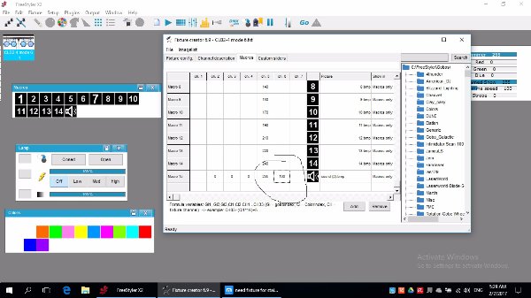

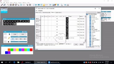

alfa156
Re: need fixture for stairville clb .2.4
hi again! finally i use the mode with 7 chanell and it works correctlly but after 14 macros icon has an icon with a speaker.when i press it nothing happened and the par stack on.i thing this icon is to enable use the par with sound.you know something about thiw function?
- Posts: 905
- Joined: 16 Nov 2016, 14:24
- FreeStyler Version: 4.1.7
You are correct. Clicking the speaker icon sets the instrument to react to sound. I think the instrument has a built in microphone. Again, the dimmer must be set high enough to see light. I've never used sound control but I think the PARs should change color to the beat of the music.
What did you need to do to get the instrument working?

alfa156
the only thing that doesnt work is the icon with a speaker,there is next to macros icon.
- Posts: 905
I found a setting detail I missed. I've updated the speaker macro. This may fix the issue. Download and import it.
The detail is that channels 2, 3 and 4 MUST be 0 to allow sound mode to function. I changed the macro to set channels 2, 3, and 4 to zero.
Also, other fixtures I've looked at have a sound intensity/sensitivity control. I did not see this in the documentation but there is a possibility that channel 6 (labeled Programme speed) may control sound sensitivity. Once you select the Speaker macro try varying channel 6 to see if that helps.
Remember that there must be some sort of varying sound that the instrument can hear for sound control to really function.

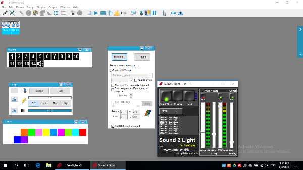

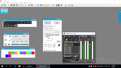

alfa156
i download the new file,i import inside,but the same,doesnt work on par led light!see the print screen
- Posts: 905
I see you are trying to use the Sound to Light Freestyler plug-in. This plug-in is completely different from the Speaker Macro. The plug-in varies selected DMX channel values on the selected cue sequences - it has nothing to do with the instruments ability to react to sound.
The instrument should react to sound (that is loud enough and has a discernible beat). Have you tried playing some loud music with a strong beat after you've clicked on the Speaker icon? Try this first with channel 6 set to 0 and then try it with channel 6 set to 100.
alfa156
hi!i change thw value of chanell 6 to 0 and to 100 but nothing happend yet!i played loud music near to my led pars.The par deticated works with sound,to see if my system has a problem and it doesnt work,but finally works normally.
I'm sorry but I am confused. I understand that Channel 6 does not control sound sensitivity. I understand you played loud music near your LED PARs. I do not understand your last sentence. Would you be so kind as to rephrase your last sentence and maybe that will help me understand what you are telling me.
Thank you
Thank you
alfa156
ok! sorry its my fault.i wrote wrong sentences!!! the stairville clb 2.4 has builtin sound controller ,and can work with sound alone without external controller etc,i tested with loud sound and works normally.now i need to use it via freestyler programm this function but i cant use it yet.
