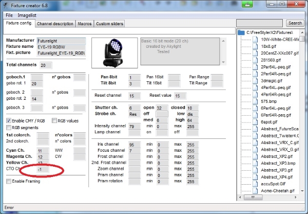

Hardcoreman
Re: Futurelight EYE-19 RGBW
Thank You! Everything is OK, BUT after export, something changes the values. I use Fixture Creator 6.8. I don't understand why happened this. Now I upload the original photo and fxt file.
RGBW-packed.zip- (4.95 KiB) Downloaded 118 times
Hej
I have looked on the zip file fixture.
Some of the COT images are missing in the zip version so it is not usable for others.
And I have been debugging on the pff file.
It looks like Fixture creator don't like the two lines in Channel description where you have "," in.
I have not tried to se if it is the "," or an other illegal char which has been used so I have just tried to delete description on channel 6 and channel 20.
When I do this then it is possible to export and import the fixture correct.
I will add this to issue to the bug tracker.
