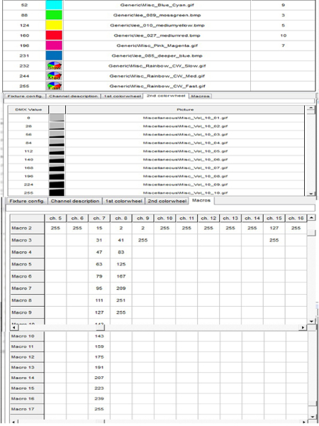

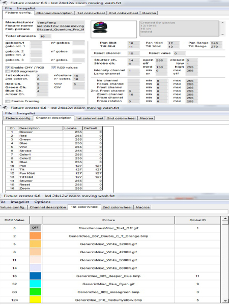

i need your help, i have led 24x12w zoom moving wash, i already create the fixture, all work correctly only few i do not know how to fix, like when i hit button "blackout on" it still "alive", second problem when at strobe, i hit button open, the speed for pan/tilt going slow, third problem, the fixed colors not work correctly..
hope anyone can help me which part that is wrong..
here i attach picture for the fixture and picture for the user manual
need help to make correction on fixture

I had a look on your pictures.
I noticed that you have channel 14 "Pan Tilt Speed" on shutter. Remove that.
Strobe channel in the off field set that to 0.
That should clear some of your errors.
