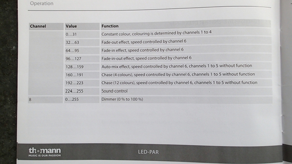

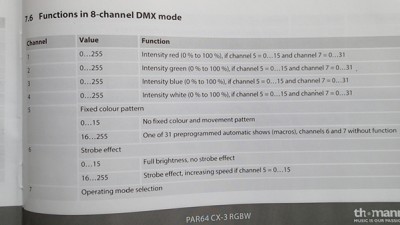

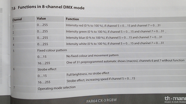

I tried to make it on my own based on an other stairville LED-Spot, but I have no Idea how to get all these functions into my fixture. Please HELP

You are on to the right thing when you place the channel 7 functions in the "macros"
I can see that you have placed the values in channel 1. That is wrong. They are to be in ch 7.
Also I would make the first value 0 to a icon with the text "OFF" because you switch off the macro / mode function and goes back to normal mode.
The chanal 5 I would place on the color wheel and then you have to find the value where it shifts colors and enter them in the table with a icon that matches. (also here you need a white or off as the first icon.
