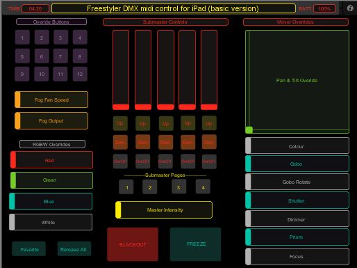

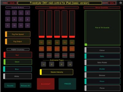

Im using a more complex version of this template to run FS for shows. I works perfectly.
I also have a mini version on my iPhone. Both can be used at the same time.
So far Ive had 2 iPads and 2 iPhones all hooked up on the midi bridge to FS. Nothing went wrong!
What do you want for free ?

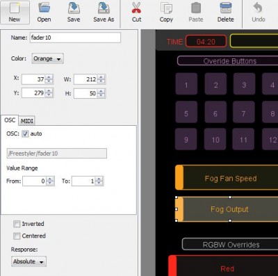

OK heres what you need to do... (from the begining, this is for anyone wanting to use this!)

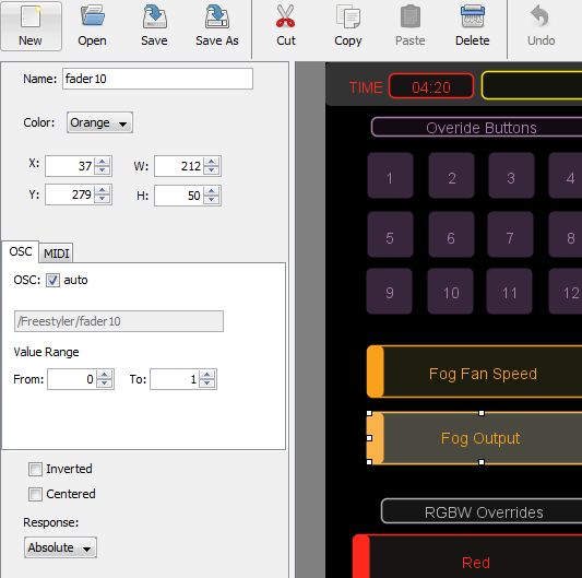

Open TouchOSCeditor and create the page template as you want it. This can be really time consuming and I am always making changes to my layout. Or download the one I posted on another thread.
Then edit each button, fader, encoder and assign each with a midi channel value. All you need to do is click on each one in turn and edit the info on the left side of the screen...
You will notice that there is a choice of OSC or MIDI on a little tab. Ignor OSC and click ob the MIDI tab!
The only bits you need to change are put a tick in the little box next to the 'x' and the 'NUMBER' for each button or fader etc.
var: X
Type: Control Change
Channel: 1
Number: (this is the variable from 0 to 127 and each bitton, fader needs a unique number)
Range: 0 127
Once you get more into this you might want / need to change some other other stuff but this will be enough for now!
Once you are done save it.

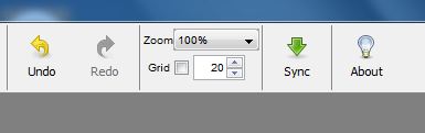

Make sure you have downloaded the TouchOSC bridge and that it is running on your PC. Your PC and iPad MUST MUST be connected to the SAME wifi network.
Now click on the SYNC button on th OSC editor. If you dont do this then you can't connect to your iPad!!!!
(13.82 KiB) Downloaded 7 times
