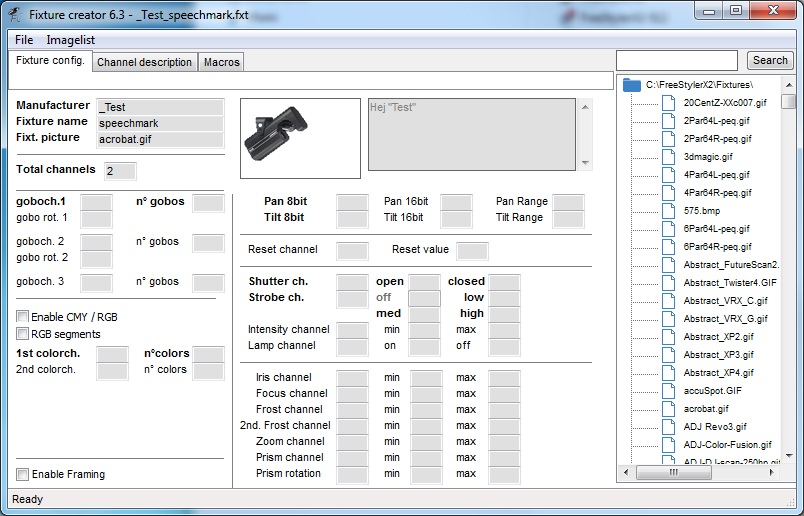

Re: Lanta fireball LED par64S
also noticed that putting speech marks " in the comment section of fixture creation corrupts the file when saving. Found this out the hard way!
Jan_K
- Posts: 1155
- Joined: 04 Jan 2011, 21:57
- FreeStyler Version: Beta
Something like this?
