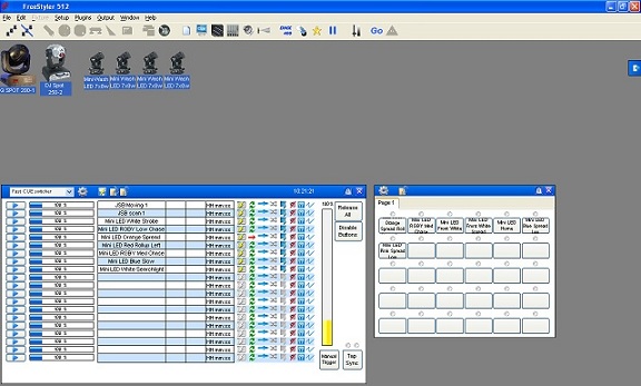

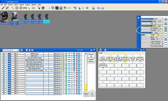

See if I can explain this better. Upon starting FS, my site starts with the cue and override button windows open.
Startup
Startup

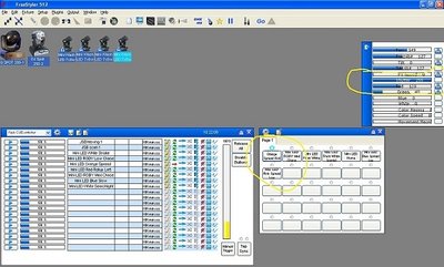

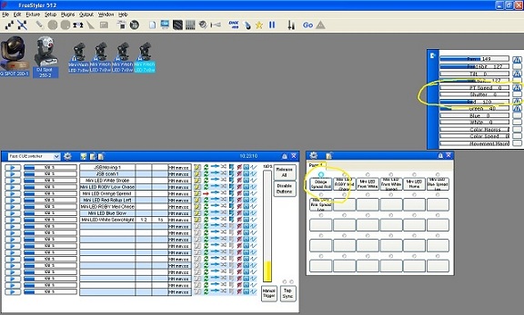

If i choose an override button, the scene displays as it should.
Override button settings before running sequence

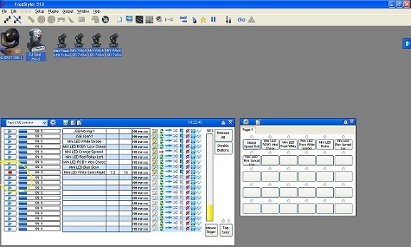

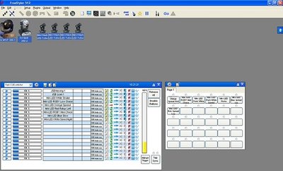

i can switch to other override buttons as well and everything is fine. i can also choose to run a sequence in the cue window and that is ok.
running sequence
running sequence

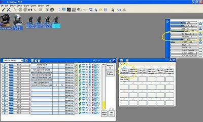

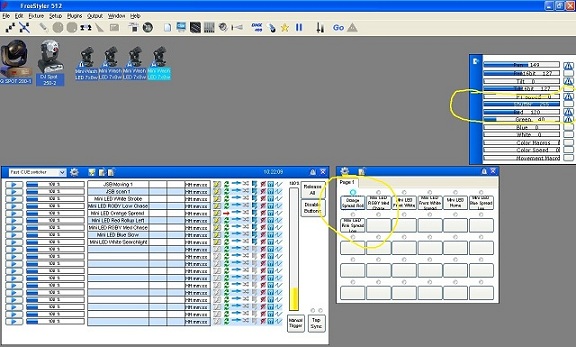

i can choose other sequences to run and they are ok. If I go back and try to use an override button AFTER running a sequence, the shutter shows as being "0" instead of the "255" that it is saved as.
same button AFTER running sequence
the colors, pan/tilt, etc do not change, only the shutter defaults to "0". On the cue window, I have enabled and disabled the "release all and disable override buttons", saving and restarting after changing it, with no affect. The programming of the override buttons all show a shutter setting of "0" after running a sequence.

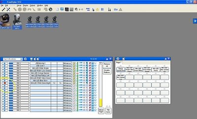

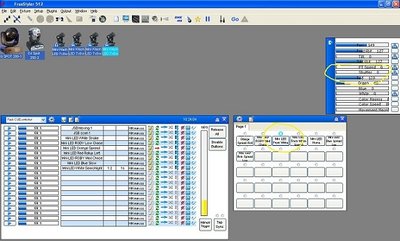

another button AFTER running a sequence
If I restart FS, everything is ok again and the shutter settings on the override buttons go back to "255" as programmed. After stopping a sequence, i do not show any overrides (blue triangles) that should be resetting the shutter to "0" on the buttons. Hope this helps. thank you.
