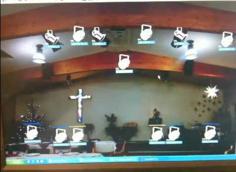

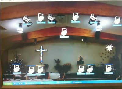

this is our fs screen:
so at the top there a from left to right:
1000 fresnel, led par, 1000 fresnel, led par, 1000 fresnel, led par
in the middle: led par
on the floor: three led pars each side
i dont know if my set up in fs is correct, but right now we are using sequences in the cue-window and trigger them using the play button, after clicking the play-button again my light turn off (restore value feature).
so we have some seqs with the fresnels and leds mixed, and as a kind of wall washer some seqs with different colors from the leds at the bottom for the wall.

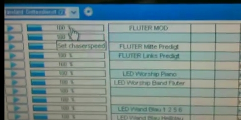

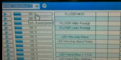

Ok, this is a bad photo of our cue list... ;)
e.g. the "FLUTER MOD" seq uses only two fresnels...
the "LED Worhip Band Fluter" uses the 2 fresnels and 3 leds...
