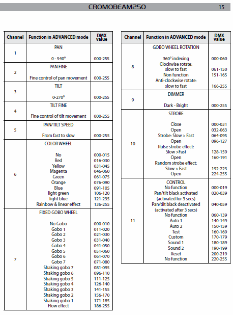

I've tried to make my CromoBeam 250 fixture for Freestyler but it doesn't work. I don't know why. Can somebody help me on this fixture, please? Tanks to all.

Sorry, I've forgotten to add this capital (?) info. It can be the same with the Showtec Indigo Beam fixture, I'm not quite sure. So If anybody has this fixture, it can help too.
And here is the DMX descrisption attached.

So, there is no response from the Cromobeam when i try to control it buy dmx. I don't know if it's a problem with the dmx on this Crombeam (i have two of them and it's the same problem) or the problem is with my fixture.Spirit wrote:can you discribe you issue.
so i can help.
/spirit
If anyone can try the fixture and tell me if it works or not. Or look after the fixture and tell me if there is any problem with it.
