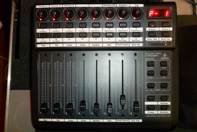

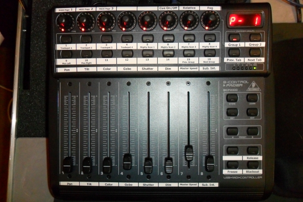

@Spirit - My band has been playing a few festivals over the summer where lighting is provided. It's been nice having someone else do all the heavy lifting. Your post got me to thinking so I had to set up my board. You are correct; 10 group limit. I haven't used the MIDI to DMX feature but that's a workable solution.
@Steven789 - If you've got a BCF2000 why do you want to use the mouse? Before I got mine it took about 3 hours to tweak the fixture positions for any given stage. Now I can do the same thing in less than an hour. Using the mouse to interact with FS is cumbersome during programming and a nightmare for live performance. Assign as many things as you can to the controller and label it. Here's a picture of my board.
