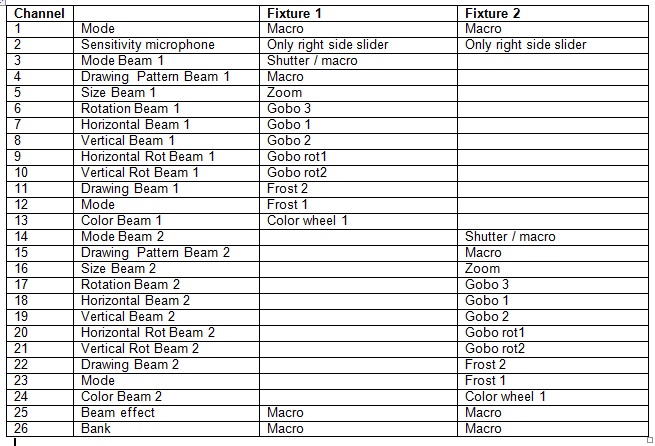

I had a brain accident so I copied the French DMX table into a word doc and used google translate.
Can you have a look on the text and eventually correct what google missed in the translation.
That could be a start.
Also you said 24 channels.
The DMX table have 26 ?

I had a closer look on the table and I think you should make 2 fixtures, one for each beam, and then use them as combined fixtures.
Placed on the same start address.
See eventually the tutorials on the wiki.
I think I would split them this way.
There are a lot of patterns where you have to figure out how they are configured.
My guess is that they are controlled by channel 4/15 and channel 26 in combination.
You probably don't the images for the patterns so give them a number icon.
There is also a laser tutorial on the wiki.

I think you will get the best performance if you split this in two fixtures.
Else I think you will end with a lot of faders which you don't have any feeling with.
There are some tutorials of how to use combined fixtures.
http://www.freestylersupport.com/wiki/f ... d_fixtures
http://www.freestylersupport.com/wiki/f ... ter_effect
There is also a lase tutorial but lasers are in general a bit difficult to control.
