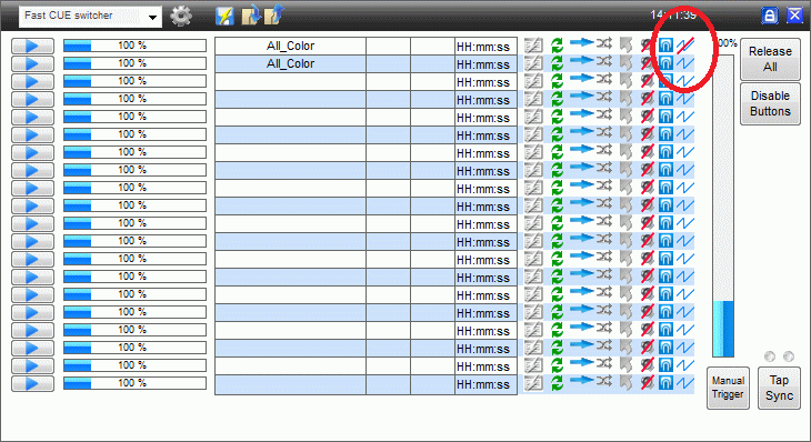

Create a sequence for example a color shifting with fade between the shift.
The faders are in “fade” mode.
Save the sequence and add it twice in the cue window.
In the cue option behind each sequence there are a “Disable all fades” button.
Enable it for the first sequence.
Save the cue and note that all these option settings will be saved with the cue.
When the sequences are played back the first one with the red line across will play the sequence with no fade and this will be like if “Snap” has been used.
The second one will be the played back the way it was created with the fades.
It is the same sequence but just played back in two different ways.
