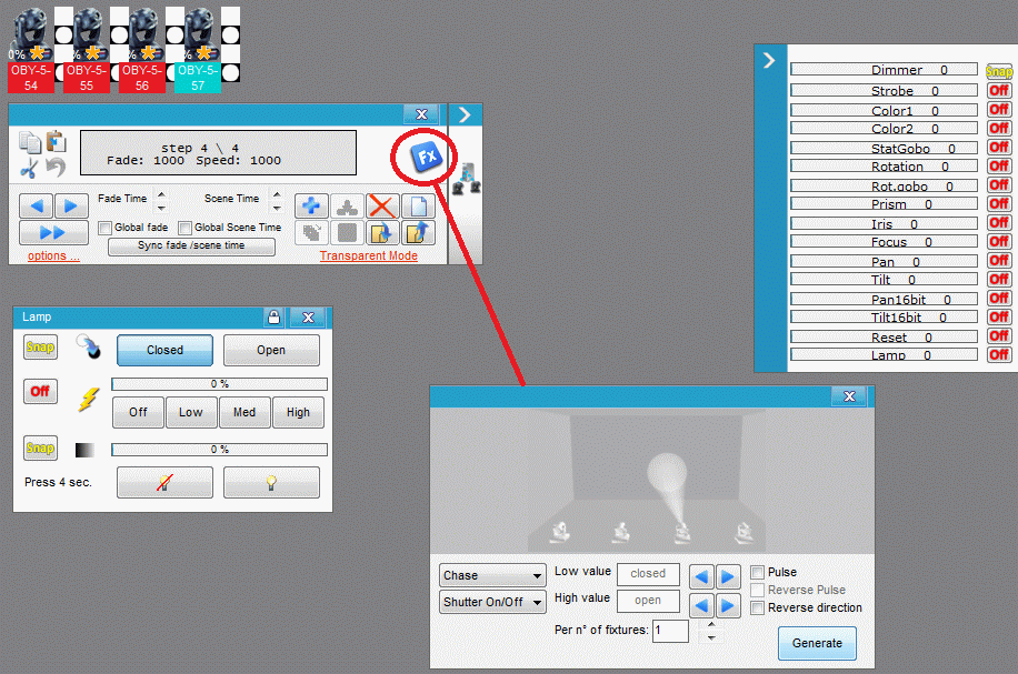

Open shutter is select all fixtures and in the lamp panel “Open”.
As it can be seen then all 3 controls are “snap” and covering the 2 Shutter and intensity channels.
To generate the shifting light Freestyler has a build-in “FX” generator.
Select the Moving head fixtures, Open Sequence editor and press the “FX” button to open the FX generator.
In the FX Panel select the pattern and the channel it has to be attached to and press “Grenerate”.

The FX can generate “Chase”, “Cascade”, “FlipFlop”, “Inverse Chase”, “In & Out”, “Can-Can” and “Special” so this is the sequences that are generated here.
Open the cue window and if it is now empty then clear it.
Add all the created sequences and save the cue as “Shutter”
