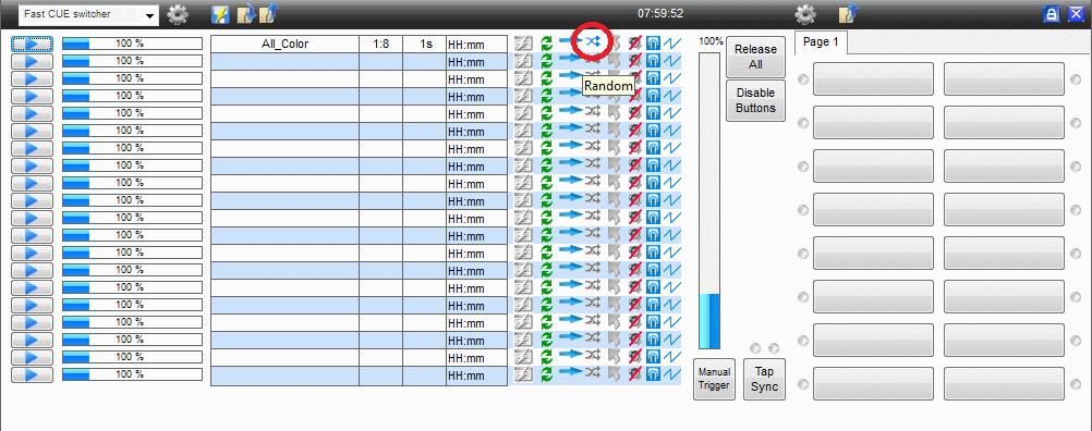

The issue is to make a sequence, add it to a cue and then let FreeStyler select a random scene / step in this sequence.
Open Sequence Editor
Add scene one by one.
White, “+”, Red, “+”, Blue, “+”, Yellow, “+”, Green, “+”, Pink, “+”, LightBlue, “+”, Violet.
Save the Sequence.
Insert the sequence in a cue and enable Random.
The playback will now be the color steps in a random order.
