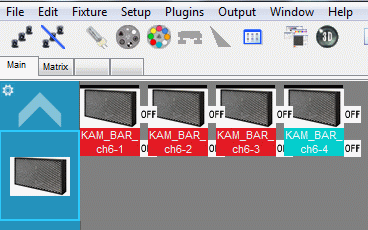

When the “Group” is checked “Off” only one family group can be selected at the time.
The family is selected by mouse left button click.

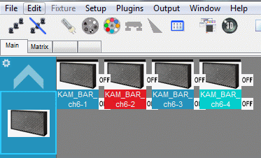

With a mouse right button click each second fixtures are selected. This each time the right button is clicked the selection is shifted. This means odd , even.

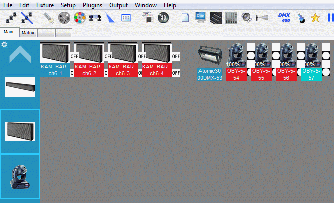

When the “Group” is clicked “On” then multiple family groups can be selected with the mouse left button click.
There is no function attached to the right button.
