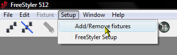

When FreeStyler has been started you will see a menu/toolbar at the top left of the screen like the one below.
Click “Setup” in the menu and then click “Add/Remove fixtures”.

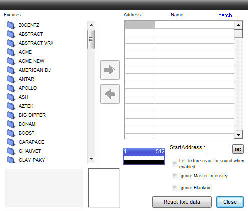

You should now see the following dialogue box in the centre of you screen.

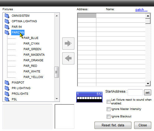

On the left of this dialogue box is a list of lighting manufactures of existing lighting fixtures. Click the folder to expand or collapse the list of fixtures contained within.
Below this will be the description and picture of the selected fixture.
On the right of this dialogue box is a list of fixtures already added (patched), including the address and name.

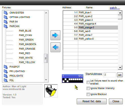

Below this is a dipswitch image which will show the dipswitch settings of a fixture selected from the list of your patched fixtures. In this image a dispswitch is off if up and on if down. use this to set the dipswitch of fixtures that require this type of addressing.
Next to the dipswitch is a control where you can manually change the address of an existing patched fixture if you need too.
Three controls below this allow you to set some features of how your patched fixtures will re-act with FreeStyler.
Below this are two buttons, “Reset fixt. data” which I do not know what it does and the “Close” button will close this dialogue and reurn you to the main FreeStyler screen.

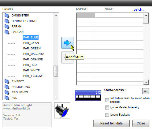

Scroll down the list of fixtures and find the “PARCAN” folder, click the folder to expand it.
Select the “PAR_BLUE” fixture by clicking it. Notice a picture and some information about the fixture appears below Now click the arrow that points to the right to add it to your list of fixtures.

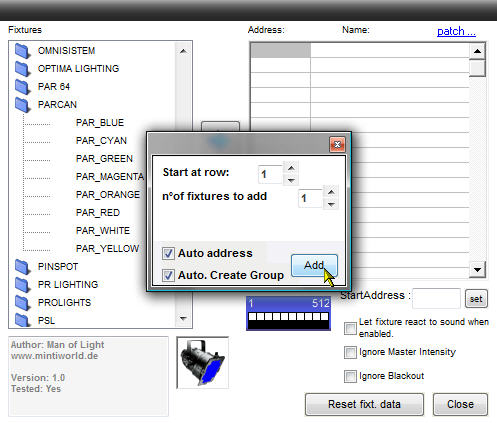

A little dialogue will pop-up, this shows the row to start at in the list, the row has nothing to do with DMX addressing it is just it's position in the list on the right, the number of fixtures you want to add, there are check (tick) boxes to enable auto-address and auto-create group.
For now just press the “Add” button to add the fixture to your list.

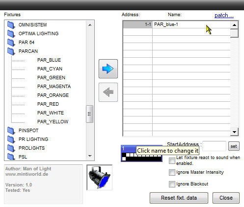

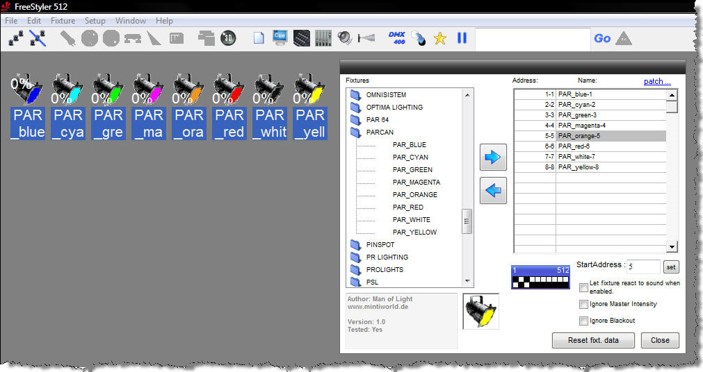

Now you can see the par can has been added to the list on the right. It shows it is using an address range of 1-1 which means one channel is used by this fixture. It has also been given a name of PAR_blue_1. If you wanted to change the name that has been created then just click in it as is shown by the balloon tip and then you can use the backspace key to erase the name and enter your own.
For now I want you to add 1 each of the rest of those PAR Cans, just do what you did above.

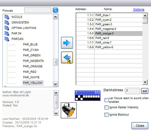

If you have done everything correctly then you should have 8 PAR Cans as shown in the above list.

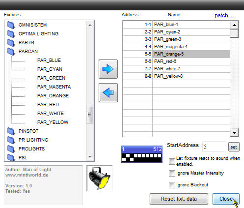

I have clicked on the PAR_orange_5 fixture to show you the dipswitch settings.
If your fixture has dipswitches to set the DMX Address this is very useful to you so you can see what dipswitches need to be on or off for your fixture. The dipswitch picture shows switches that are off in the up position and one that are on in the down position. As you can see this PAR Can is at address 5 and we have dipswitches 1 & 3 on which is binary for 5. For more information on dipswitches see the definition DMX How to set the addresses on the fixtures in The DMX Wiki.
Remember your fixtures dipswitches might be on in the up position and off in the down position. It depends on the fixture. Some dipswitches show the on position.
Looking back at the FreeStyler main screen you can see the 8 PAR Cans that have been added/patched. You might want to change the names so they are easier to read as you only get a short name on the screen for each fixture.
To rename a fixture just click on the name of the fixture you want to change in the list on the right and then press the backspace key to delete its current contents, now type in the new name for it and press enter. I am not going to show how to do that as I think the explanation is clear enough.

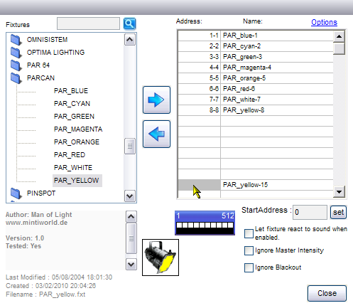

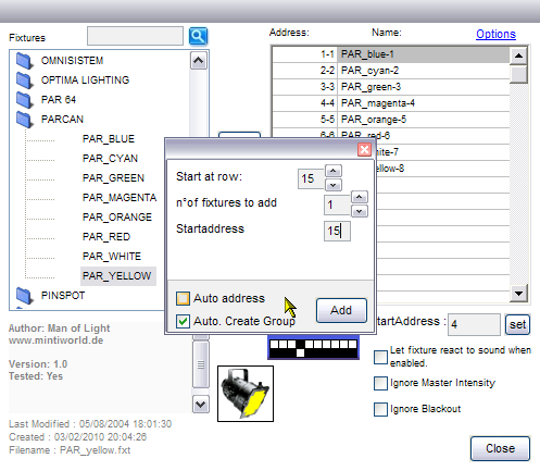

OK lets patch another PAR_yellow, ensure you have selected the PAR_yellow and the click the “add fixture button”. You should see the familiar dialogue as shown below.
As you can see I have changed the column to 15, the reason I have done this is to seperate it from the rest of the fixtures so it stand out easier in this tutorial. I also have changed the address to 15, this is actually not necessary as it is ignored if manually addressing a fixture ???? I have also un-ticked the “auto-address” tick box, well we are patching a fixture to an address we want rather than what FreeStyler wants to address it to.
Click the “Add” button.

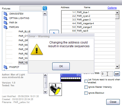

Now we have to actually set the address of the fixture, so click the fixture in the list on the right that you need to set the address for then click in the “StartAddress” input box and you get the prompt shown below.
Click the “OK” button.
Now type in the address you want to set the fixture at in the “StartAddress” input box and press the “set” button.
Now you can see the address has been set at 15 and it is in row 15, which I set in the dialogue.
That is how you manually address fixtures in FreeStyler.

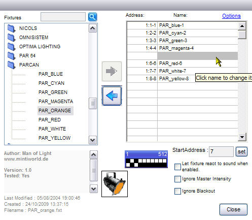

Remove fixtures

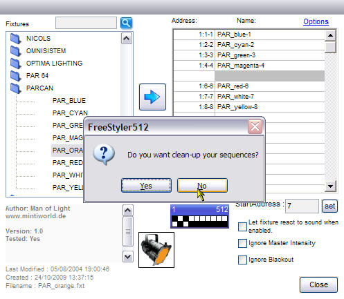

To remove fixtures you would open the “Add/Remove fixtures” dialogue from the “Setup” menu then select the fixture that you want to remove in the list on the right and then press the blue arrow that points left to remove it from the list.
You will be given a prompt when you click the blue arrow that asks “Do you want to clean-up your sequences?”. What the Sequence Cleaner does is enable you to select any sequences you have and removes the channels associated with the fixture you are deleting from them, keeping your sequences clean. What you decide here is up to you, experience and familiarity with the program will dictate in the end. For now just press the “No” button.
As you can see the fixture has been removed from the list on the right.
You can now close this dialogue.

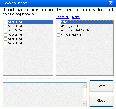

Cleanup sequences.
This function is used to remove channels from sequences. It is channels where fixtures has been removed or channel related to the marked fixture that will be removed from the sequence.

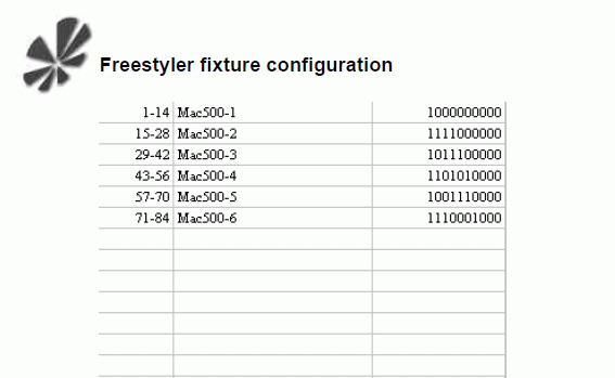

The print list looks like below where the right column is the dip-switch settings.
