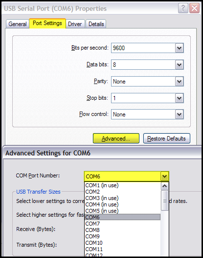

Q: When I start up FreeStyler, I get the message "Error creating output thread" and I can't control my lights
A: “output thread” error comes when FreeStyler can't find the USB interface. Make sure you have selected the right interface in FreeStyler Setup and chosen the right COM-port. If you don't know which COM-port your interface is connected to, open the Device Manger and check it. Set the right COM-port in FreeStyler Setup and restart the program.
To check or change the COM-port associated with your interface follow this procedure.

  8. Double click the entry or right click and select “Properties”.
  9. If it is an Enttec Pro then the Manufacturer on the “General” tab should be FTDI.
  10. Click the “Port Settings” tab.
  11. Click the “Advanced…” button.
  12. You will now see a dialogue which allows you to change the port associated to this device via a drop down list.
  13. See highlighted areas:
  14. If you have made changes then click the “OK” button otherwise press the “Cancel” button.
  15. Close all other open windows.
  16. Restart FreeStyler and go to the menu Setup>FreeStyler Setup>Controller to select your interface and select the correct COM Port.
  17. Save your settings.

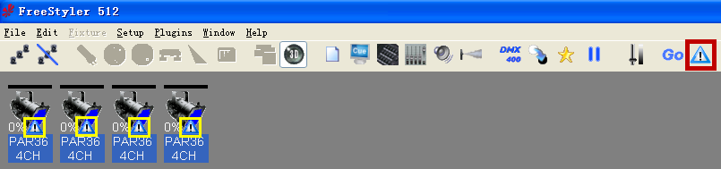

Q: I can see a blue triangle mark (!-sign) next to the fixtures, What is this?
A: This icon indicates that a manual override is active, click on it to disable the manual override.
Learn more about this at: The Override systems in freestyler or the Blue triangle

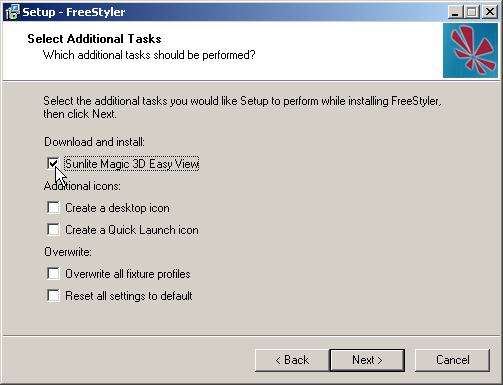

Q: I can't open the Magic 3D Easy View from FreeStyler. The "3D" icon is grey. What is wrong?
A: Magic 3D Easy View is either not installed or not installed in the FreeStyler folder.
When you install FreeStyler make sure you set the check mark at “Sunlite Magic 3D Easy View”, otherwise Magic 3D Easy View does not get installed.
If you forgot to set the checkmark run the install again, click that check mark and make sure you have not set the check marks for “Overwite all fixture profiles” and “Reset all settings to default”. This way nothing will happen with your fixtures and setting. Only the “3D” button would be clickable in FreeStyler.
