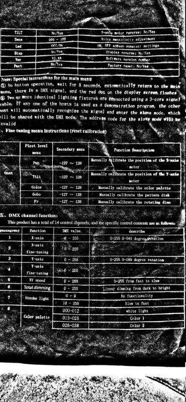

hello i am new in this lights using,i have try to create the fixture without luck,i have try too modifyy some that i have found here and i get some workings but not at 100% because it have a big speed rotate that i cant make it to run slow or med speed,not all colors working.
thanks in advance for somebody that can help me

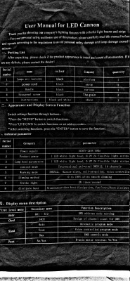

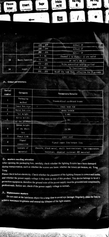

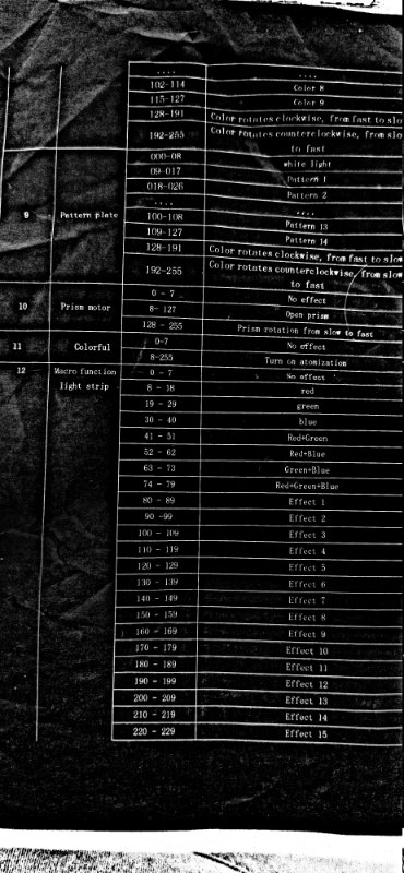

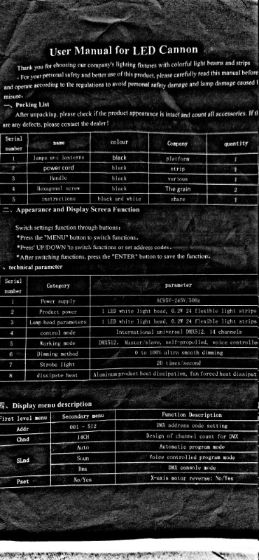

this pdf i taked from the seller shop online,i have found the manual and i maked screen to all here they are
i have maked screens with full page but letter dont appear clear so i taked screen only in dmx part

Thank you for the update. The photos show a 14 channel fixture (not all channels were in the photographs) whereas the PDF showed a 12 channel fixture. To which mode do you configure your fixtures? If 14 I will need to see all of the channel information.
If you place the user manual pages under a bright light will the letters show more clearly?

normaly i bought from aliexpres the lights but there they dont have the manual online so i searched in google for the fixture of this product and this sent me to the yuer store where this have appeared,looks like the same that i bought at title name,now when i have checked the manual and the pdf i have checked too the online lights and yes they are diferent
this is what i have buy :
https://www.aliexpress.com/item/1005007 ... 7950797579
sorry for the misunderstanding
i have maked the photos with light and yes they looks better :
https://ibb.co/fz090xQS
https://ibb.co/WW1H2Jgb
https://ibb.co/JwyP6GJy
https://ibb.co/4Zs5bbcC

Based on your photos I created the attached fixture definition.
The manual does not show Gobo patterns or the colors on the color wheel. The programming windows simply show numbers or text. If you can provide that information the fixture definition can be updated.
When you select the instrument in Freestyler you can click on Window All to open the helpful programming windows.
I used GIMP to enhance your photos so that they are legible. I've attached them also.
Regards
Regards

thanks you rod its working perfect,i have try with many options to make the best photos quality but like the letters are not clearly and for sure in 1,2 months the manual will be unusable ,i will try to make a copy as fast posible
thats the all information that i have received with the lights,aniway its working very good
i have 4 lights like this one
thanks again for all what you are doing
