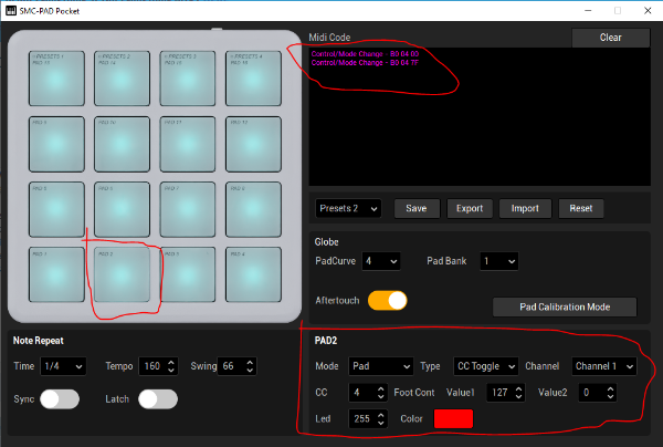

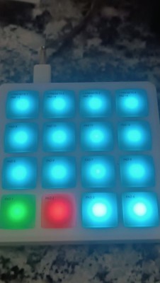

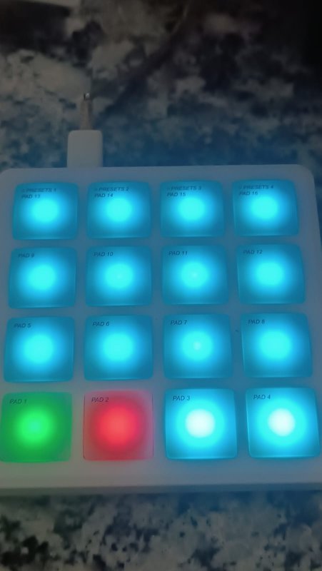

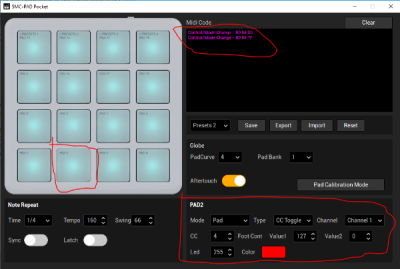

I'm using M-VAVE SMC-PAD POCKET to control scenes and overwrite buttons, etc.
When I map any toggle function, it turns on and off, but it's not behaving correctly.
Ex:
When I click the first time, it turns on.
When I click the second time, it doesn't do anything in FreeStyle, but the pad turns off.
When I click the third time, it turns off in FreeStyle, but the pad turns on.
In other words, it seems to be sending double or repeated commands. I don't know how to solve this.
I would like the first click to turn on, the second click to turn off both the pad and the freestyle.
